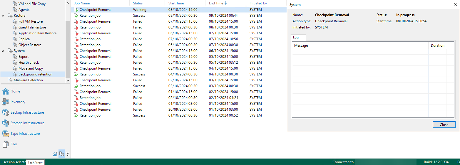

Hello everyone,
I just wanted to report it seems that we are also affected by the bug that since updating VBR to version 12.2. we receive mails with the subject “Failed to remove a checkpoint during a background job on ... “.
I am working with the support team on this issue under the ticket number “Veeam Support - Case # 07430089”.
So far we have been able to improve the situation a little bit with some registry keys for adjusting "S3RequestTimeoutSec", "S3RequestRetryTotalTimeoutSec" and "S3ConcurrentTaskLimit", but the problems are not completely gone.
Unfortunately, it is currently unclear to me how I can see whether a checkpoint removal process is currently running or not.
I also see error messages in the some backup logs, which I never noticed before 12.2:
We monitor the S3 instances with Grafana, but unfortunately I am not able to interpret the values shown there correctly.
For example, there is an “S3 API Request Error Rate (4xx)” that spikes regularly and I don't know if this is normal or not.
I seem to lack a lot of background knowledge about when Veeam talks to the S3 instances and how, and what is queried or written and when.
This is just a reference to the running ticket as our environment is complex.

Post-upgrade to Veeam 12.2, we've started receiving emails regarding failed checkpoints.
during our troubleshooting session last week (Veeam Support - Case # 07416671 -) with ad advanced technical support, we have suggested a couple of improvements to the said feature.
A. identify in the session/email notification which capacity tier the failed checkpoint is on
B. Ability to add the email confirmation indicating that there are no more checkpoints to process if all offload jobs have been successful.

Hello Tanya,
Thank you for your feedback and sorry to hear that you've faced issues with background checkpoint removal feature. I'll share your post with the corresponding RnD team!

Often, the problem lies not in the background checkpoint removal process, but in infrastructure issues, including network-related ones. You can discuss this with your support engineer as the investigation progresses.
As mentioned earlier, this does not mean that the new product version introduced a previously non-existent problem; rather, it highlighted it.
In the next minor product version, we plan to improve the notification system by including the underlying error (infrastructure or configuration specific one) in the checkpoint removal session and report. Additionally, we will downgrade the severity of errors in the checkpoint removal process from "failure" to "warning".
Thanks!
