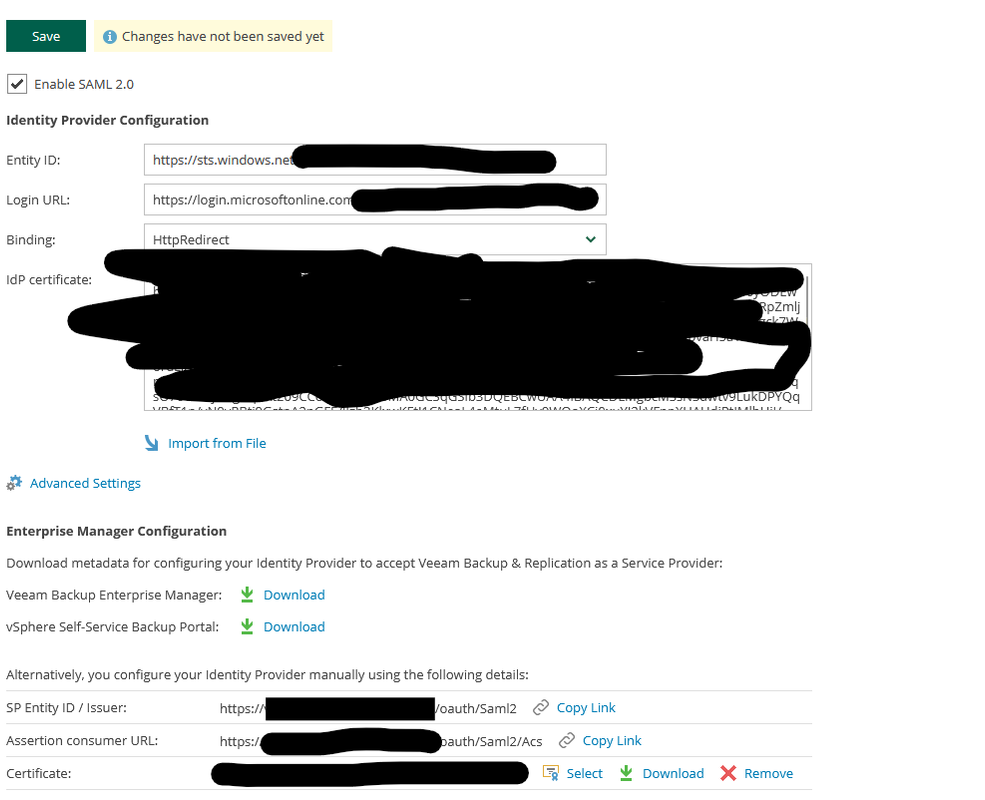

We have followed a similar process as we followed with the B&R webui to enable SAML.
So we create an o365 app exactly like we did for the B&R, and then configure EM in a similar way by
>Configuration>Settings>SAML authentication
We use the import from file option to upload the xml file we got from the o365 Entra portal for that App.
Everything good at this point.
I then go to >settings>roles and add my o365 primary identifier as an external user in there with Portal Administrator access.

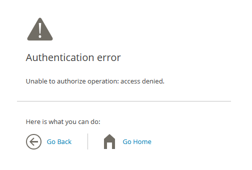

When I use the sign on with SSO option in a private window, then its gets past the o365 flow and ends up in Veeam with an "Authentication error".
see below.

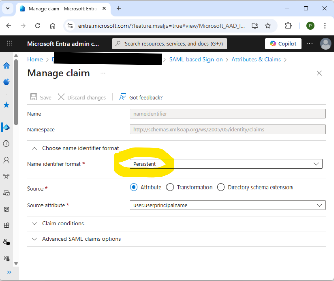

For anyone stumbling across this issue, The problem was on our side;
- The Name ID on the app needed to be changed to "Persistent" in EntraID.
- The login type needed to be specified as "unspecified" in Veeam.

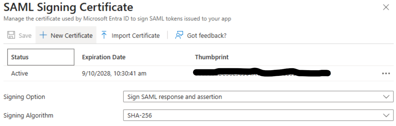

- Set EntraID to sign SAML responses and assertion
