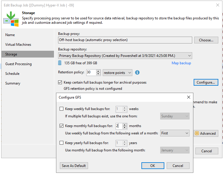

Customer currently has v9.5.4 - reverse incremental with 14 restore points, daily backup.
How could I achieve, in addition to this, a restore point from 30 days (1 month) and 60 days (2 months) so in total we have 2 weeks (dailies) and 2 months all kept locally?

Hi Wayne.
Quick and easy way:
- create a Backup copy job with GFS - Monthly - 2 set
"The right" way(aka in customer's best interest):
- Upgrade to VBR v11
- Switch to Forever forward incremental mode, unless customer has _very_ specific reasons to stick with Reversed mode
- Use built-in Job GFS added with v10, just tick "Keep certain backups longer..." and select "Keep monthly full for 2 months"
/Cheers!
Quick and easy way:
