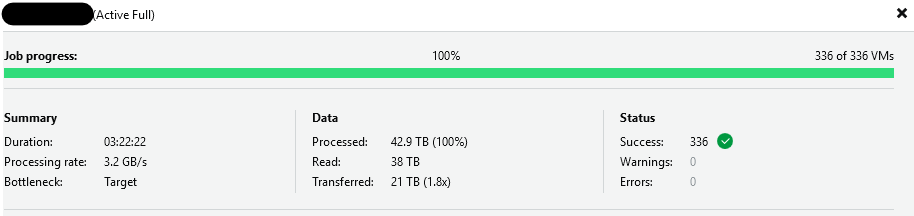

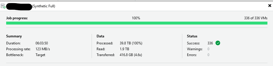

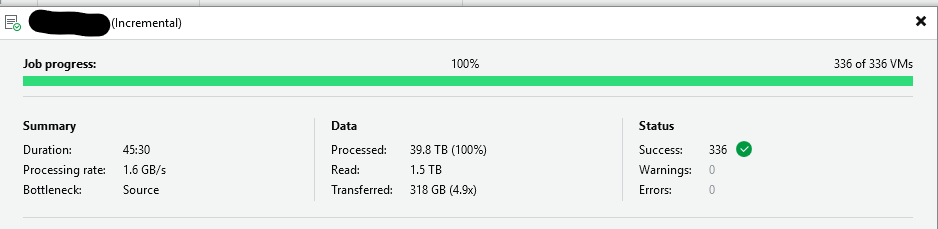

For anyone still following this, I've been running many tests under 2.3 RC3 and have the following conclusions.
- The message "Agent: Failed to process method {Transform.CompileFIB}: Resource temporarily unavailable" still occurs when synthetics are enabled and block cloning is enabled on ZFS.
- There is no currently agreed root cause as to which side of the fence the issue exists, but Veeam suspects this is related to OpenZFS. However using the OpenZFS block cloning reliability tests I've been unable to isolate the issue to OpenZFS.
- The following doesn't eliminate the errors but seems to impact at which stage in the job they occur.
-> Change blocksize from 4MB to 8MB (or even downwards).
-> Changing compression level at a job level from optimal to none.
-> Reducing the number of concurrent jobs hitting the repository.
-> The number of jobs hitting the repositories simultaneously in the transformation stage does not appear to correlate to the failures.
- There appear to be long standing issues with synthetic backups and the load they place on the target storage device even when block cloning is in use, so even on commercial solutions many people seem to run without synthetic solutions.
- As a backup target with synthetic backups disabled, an OpenZFS appliance (in our case running Rocky9 on commodity tin with a standard HBA controller, with 23 spindles split over 4 vdevs) can easily saturate a 10gb link throughout the entire period of an Active Full backup, so we are in the process of upgrading our interconnects to 25gb.
- I'm working with Veeam and OpenZFS team on figuring out the best way of moving forwards with this. (thanks to @hannesk).
- This is how active fulls are looking like with this configuration which appears to be a health throughput;

just an update.
I've been running some tests on V13 and ZFS2.3.4 and Rocky9.6 - which we have been running now since we deployed V13 a couple of weeks ago.
There are 2 unresolved issues we've noticed.
1. Bulk deletions are quite slow in ZFS.
During my testing I had to kill large test backups numerous times. Deleting 30+ TB with several hundred files took longer than expected. (in the order of 30 minutes or so). There are some changes around async deletes that can be made, but this issue seems to be more pronounced as soon as block cling enters the mix (which is the default). Slow deletions seem to be a well documented ZFS phenomena. I don't consider this a blocker as this activity is mostly drip fed during Veeam workloads rather than doing mass deletions like I've been doing.
2. Performance of Synthetic Fulls is slower than expected.
As part of my performance testing, I ran an Active Full backup, followed by two incrementals followed by a synthetic full.
Active full duration: 3hr22min, Processed: 43.9TB, Read 38TB, Transferred 21TB, 336 VMs
Incremental duration: 45min, Processed: 39.8TB, Read 1.5TB, Transferred 318GB, 336 VMs
Synthetic full duration: 6hr3min, Processed: 39.8TB, Read 1.9TB, Transferred 416GB, 336 VMs
During a synthetic full cycle, each VM will very quickly have an incremental done on it, and then the the status on the specific VM in the job will change to;
“Creating synthetic full backup (xx% done) [fast clone] ”
I'm assuming that the cloning process duration is related to the number of cloned blocks on the storage repository relating to the VM backup.
out of the 6hr 3min, I'd estimate 5hr 15min of this are while the various VMs are in the middle of the Creating synthetic full backup stage.
Theoretically the performance of the synthetic should be much closer to the performance of the Incremental, as on a Synthetic run, an incremental will first be made, but then the block points should kick in to make the speed of the synthetic full relatively quick after then.
This doesn't appear to be the case, as you can see by the duration, the synthetic full took nearly twice as long as the Active full.

active full
incremental
synthetic full
