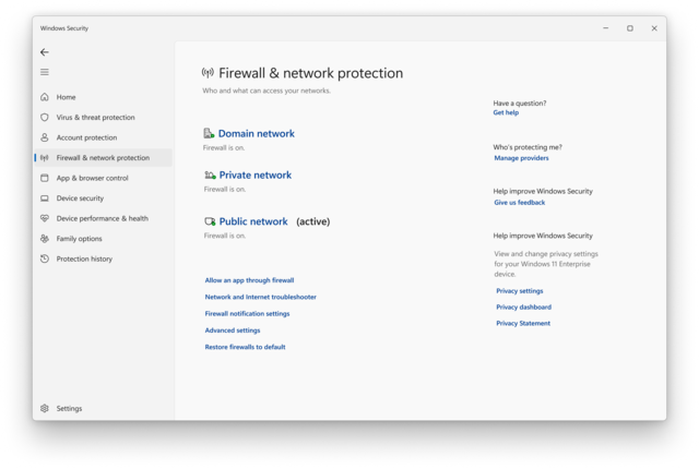

Security & Compliance Analyzer checks only Backup Server settings, firewall should be enabled for all network types:
More detail regarding this topic you can find in Security & Compliance Analyzer - User Guide for VMware vSphere.
Thank you!
- Domain
- Private
- Public
Thank you!
