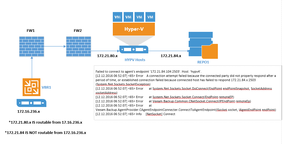

Hello the case ID 02002661 is my case, and thought I'd add a little detail
VBR1 is located on the 172.16.236.x subnet , and HYPV Hosts are all in the 172.21.80.x subnet. VBR1 only knows the HYPV hosts on 172.21.80x (defined in DNS), and 172.21.84.x is non routable from 172.16.236.x
What we are seeing, similar to Ian above, are entries in the logs , where the VBR server appears to be trying to establish connections on the non-routable sub net
Code: Select all
Failed to connect to agent's endpoint '172.21.84.x:2503'. Host: 'hypv4'.
[12.12.2016 06:52:07] <65> Error    A connection attempt failed because the connected party did not properly respond after a period of time, or established connection failed because connected host has failed to respond 172.21.84.104:2503 (System.Net.Sockets.SocketException)
[12.12.2016 06:52:07] <65> Error       at System.Net.Sockets.Socket.DoConnect(EndPoint endPointSnapshot, SocketAddress socketAddress)
[12.12.2016 06:52:07] <65> Error       at System.Net.Sockets.Socket.Connect(EndPoint remoteEP)
[12.12.2016 06:52:07] <65> Error       at Veeam.Backup.Common.CNetSocket.Connect(IPEndPoint remoteEp)
[12.12.2016 06:52:07] <65> Error       at Veeam.Backup.AgentProvider.CAgentEndpointConnecter.ConnectToAgentEndpoint(ISocket socket, IAgentEndPoint endPoint)
[12.12.2016 06:52:07] <65> Info     [NetSocket] Connect
We do have network traffic rules defined in VBR console, but I would have thought this only applies to data traffic not management traffic?
Hope the extra info helps

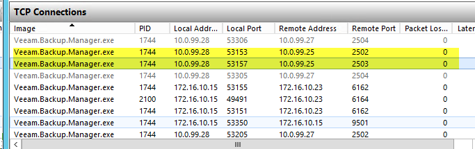

This maybe the proof to show that the backup manager is using the data mover network.
Check out my blog at www.snurf.co.uk :D
I'm confused with your setup a little bit - as far as I can see from the picture the repository is located in the 172.21.84.x subnet that is not routable from VBR subnet. That might be a dumb question but how did you manage to add a repo from that network? Repo should be accessible from VBR.
