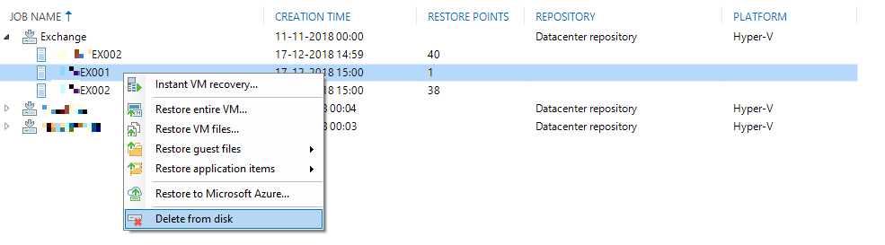

And that simply states there is 41.8GB data in a 620GB file. And just to be clear; I removed the xxxxxxxEX001 data by doing this:
I don't know how to get that data out of those files. It consumes what is extremely precious space until new hardware arrives and is put online.

But still, is my assumption correct that when I delete a vm from the backup files the way I did, it should free up the space? It certainly does a lot of work when I do that action.
Unfortunately, it's not. Basically it marks blocks (not filesystem blocks, but backup blocks) inside backup files as 'free'. Those blocks will go away only if transform or compact operation occurs. Since you have periodic fulls enabled, those blocks won't go away until the corresponding backups files are deleted by retention. A somewhat unpleasant workaround to gain some space would be to temporarily reduce the retention value so that the trailing backup chain can be deleted earlier.
