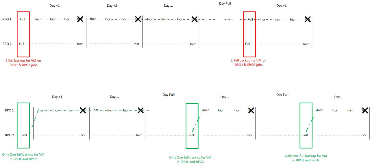

I have a little... complication on my insfrastructure. I got a new infrastructure with VBR and the solution that our partner sold to my company (before I took the topic), is a combinaison of file backup.
to give you the contexte :
- some vm has to be saved 4 times a day and other one daily.
- retention for the first batch is 14 days and the second one is 30 days
- vm on the first batch have to be included on the second batch
and what it's a big issue for me, is that our Veeam partner (and Veeam Sales......) talked about possibility to configure the second job to include the vm from the first job (ok), but have only one full backup file for both.
For me that's not possible. Each task have this own backup. And the size of ou storage is very impacted because we have several full backup for the same VM because include in different job and the cost increase terribly indeed. we already have deduplication enabled on our StoreOnce, but we already added storage because the original sizing was not realistic
so, someone have an idea of how to optimize it or a way to do the concept that they sold ?
The first part in the schema is what we have right now, and the second one what our Veeam Partner sold to my company.
You would be correct. Each job will maintain its own backup chain and will not be able to share a single full backup file between two separate jobs.
