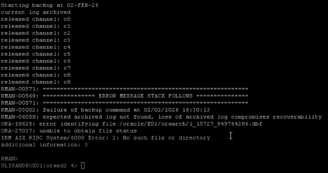

This feature is crucial for streamlining our monitoring process. Currently, the Veeam Plug-in for Oracle RMAN is installed as an agent on our IBM AIX machines. When an Oracle Database backup is performed, the Veeam Backup & Replication (VBR) 13.0 console only displays basic database backup statistics.
During the RMAN backup process, the Spool Log is stored in a local directory on the AIX machine. While we currently monitor these logs at the OS level, it is vital for our operations to have centralized visibility. We kindly request a feature that integrates the monitoring of RMAN Spool Logs (including Archive Log status) directly into the Veeam Console alongside the standard Oracle Database backup progress.

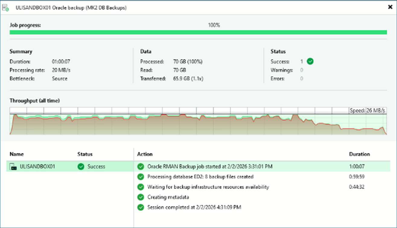

We encountered an error in the Archive Log during the backup process. While the Veeam Backup Console 13.0 reported a 'Successful' status, the RMAN Spool Log at the OS level showed a failure. This discrepancy between the Veeam Console and the actual RMAN logs is a major concern for us, as it makes accurate monitoring impossible.
We kindly request feature that the Veeam Backup Console be updated to monitor and display the RMAN Spool Logs directly along with Oracle Database Backup Process. Specifically, we need the visibility of the Archive Log backup process within the console to ensure seamless, centralized monitoring. Integrating these logs would allow us to verify the full backup status without needing to manually check logs at the OS level.
Current Setup:
IBM AIX Machine Standalone mode with Veeam Agent and VeeamOracleRMANPlugin Installed
The monitoring of Oracle Database Backup is shown in the monitoring statistic of VBR 13.0 Console.
Current Setup:

Oracle Database Backup can be monitored via the Veeam Backup Console 13.0; however, RMAN archive log errors are not currently appearing in the console. To enable centralized monitoring and avoid checking two different systems, we kindly request this feature should capture and include the RMAN spool logs within the Veeam Console.
--- removed by moderator ---
After successfully backing up the database, an error message appeared from the archivelog, which did not show up in the Veeam Console 13.0. We also attempted to monitor this in Veeam ONE, but it was not visible there either.
Veeam Backup Console 13.0 Oracle Backup Job Statistic

Please note that this feature request is not limited to Oracle Database backups via RMAN; it also applies to Oracle Database restorations using RMAN. During our activities, we encountered an error where RMAN failed to retrieve database credentials. Although this issue does not appear in the VBR Console 13.0 which still reports a "Success" status it affects the actual restoration process. I hope this will be considered in your future development.

I think it would be a good thing to put this error code into the Console and maybe put in a message to recommend a crosscheck. Other backup solutions do this.
