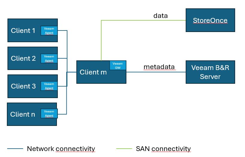

So it would be something like this:
- No veeam proxy server is actually needed
- the connectivity between the veeam gw server and the storeonce can be network or SAN
- The data will go through network from each veeam client to the server who is performing veeam gw role and then this last can send this data by network or san (depending on the configuration)

Re: Veeam backup agent against a StoreOnce Repository by SAN
Yes, this would work. Or does every client have FC-SAN access?
No they haven't. In fact we need to provide the server who will become the Veeam GW with an HBA.
The point is that all these new clients we want to back up are in a different security zone than the current Veeam B&R server is. To avoid moving backup data through the firewalls between them we evaluate the possibility of having a Veeam GW in this zone so it can move the data through SAN to the StoreOnce located in the other security zone.
We already have a Veeam GW in the same security zone where the Veeam B&R server is. I guess that another possibility would be to use that one to send the data to the StoreOnce. But in that case we would not avoid data to travel through network between security zones.
Yes, in this case the client with FC-SAN might be a good idea. I would maybe buy a "cheap" PC or workstation to let it run the gateway role that is always-on to not have to mess with one of the clients in production use. But this is maybe a cost question.
Important point is as well that you can not create 2 repositories on the same HPE Catalyst Store (virtual disk that Catalyst Clients write to) by default.
You would have to create for your clients a separate store on the HPE StoreOnce. You would loose then global deduplication between both as HPE only does dedup within a store.
I shared above the link for the creation of multiple repositories on the same store with a powershell hack.
