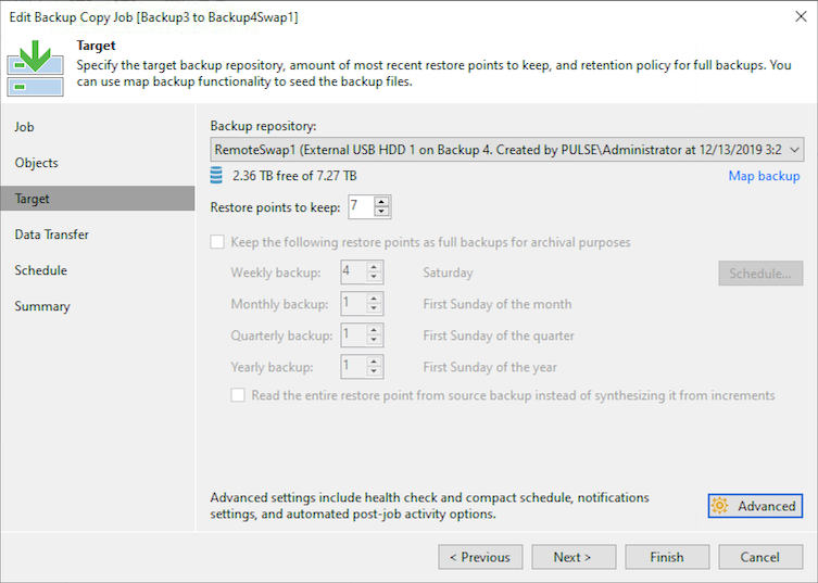

I want to use the D: drive(s) on Backup4 as an offsite repository for the backups stored in Backup3:
I created a simple Backup copy job. Full backups are OFF.

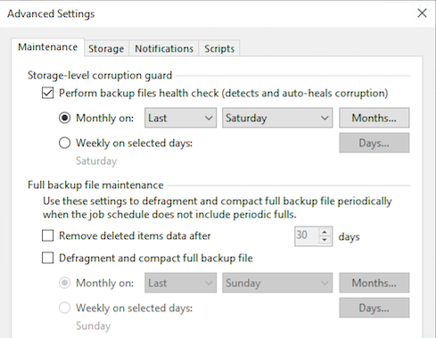

Health check is ON:

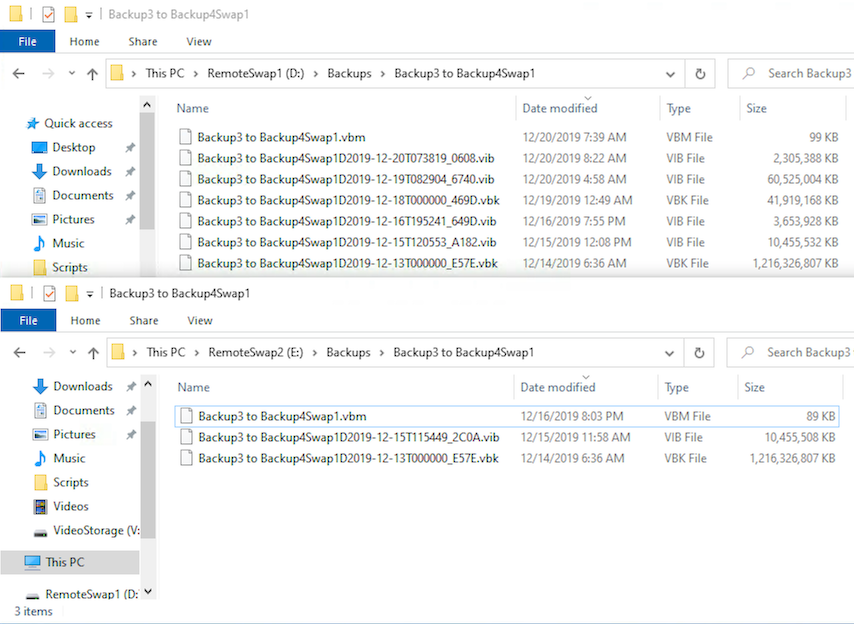

I seeded the backup drives by running this Backup copy job while Backup4 was in the main office, over GbE, then copying the Backup folder (and the 1.2 TB vbk file) from ExtHDD1 to ExtHDD2. While still in the office I re-ran the Backup copy job while ExtHDD1 was mounted as D:, and then while ExtHDD2 was mounted as D:, and both worked fine, recognizing the rotated HDD and doing the right thing. Those two jobs resulted in .vib files of about 10 GB. I did _not_ copy this from ExtHDD1 to ExtHDD2; note the size, filenames and timestamps. These two 10 GB files were created by two runs of the Backup copy job.
I ran another job inside the office, to ExtHDD1, just to be see how big a file it would create, and it made a 3 GB file on 12/16 (see above).

  1. For some reason it wants to start a full backup copy, not an incremental one.
  2. It created a VBK file, and during the run it reported "1% complete" after it had processed ~30 GB of data. Transfer rate is reporting about ~1.5x.
  3. This was after 4 hours, suggesting that this might take ~400 hours to complete.
  4. And then, of course, the job got interrupted. My pfsense box at home crashed in the middle of the night, and had to be rebooted when I woke up.
  5. I restarted the job, and this time it transferred 60 GB before the pfsense box crashed. But this time it's a VIB file.
  6. I restarted it again, just now, and it's in the midst of created another VIB file (currently at ~3 GB, and reporting as 7% completed)

  1. Is that 41 GB VBK file any good? It was a failed attempt at processing 3 TB.
  2. If it's not good, does Veeam know it's not good?
  3. Given that, is the 60 GB VIB file any good? Is it incremental to the 41 GB incomplete file or is it incremental to the 1.2 TB complete file?
  4. Is that Storage Level Corruption Guard: Perform backup files health check

Heath check is not relevant for the backup copy process. So I will skip that one.
Just to make sure: so your primary backup job is in reverse incremental mode and you tried this?
Because if you have a forward incremental chain (default), then you just need to copy the files to the target repository. Then you rescan the repository and you map the backup copy job to the existing files
I assume that you did not "map" the backup copy job.
Yes, Veeam knows if files are broken. For the initial transfer, the backup copy job can resume the transfer. You can find some more details here in the section after
If Veeam Backup & Replication fails to copy data for the full backup file during the first backup copy interval, it marks the job session as finished with the Warning status. During the next backup copy interval, Veeam Backup & Replication attempts to copy data for the full backup file in the following manner:
