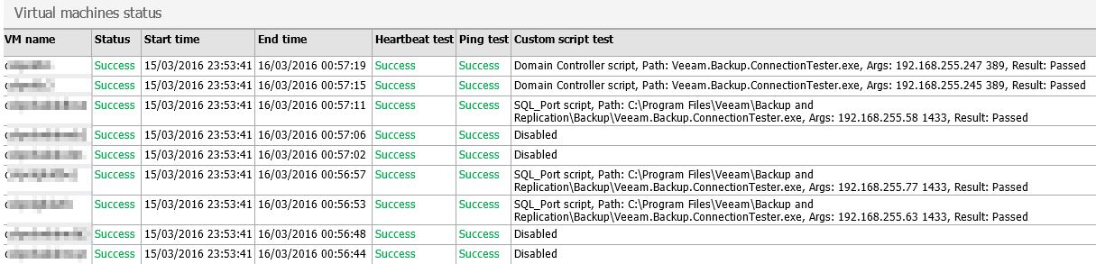

I have a weird issue, where I can replicate a VM, run a successful SureReplica job, but when I initiate a failover plan the NIC for a VM appears as disconnected. If I attempt to re-connect the NIC I get the error message ' invalid configuration for device 0'
Replication - success
SureReplica/SureBackup - success
VM after failover plan - success
VM NIC disconnected
Error when reconnecting NIC
Has anyone come across this issue before ?
