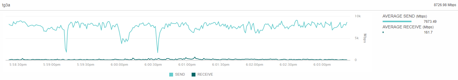

I am getting pretty good speed from my old iron.
veremin
- Product Manager
- Posts: 20754
- Liked: 2418 times
- Joined: Oct 26, 2012 3:28 pm
- Full Name: Vladimir Eremin
- Contact:
Re: Upgrading 10 to 11 did not go well
Indeed, we've introduced number of improvements to the backup engine in version 11 which are mostly notable in all-in-one deployment. Check Other enhancements > Backup Engine section of What's New document. Thanks!
