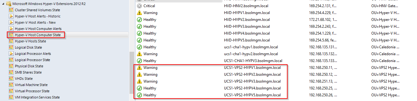

Here is what I see from the Microsoft Hyper-V 2012 R2 MP

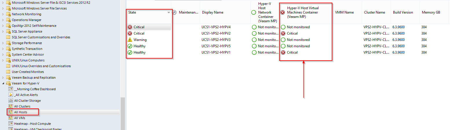

and now what I see from the Veeam MP

OK, this looks bad and unfortunate for us - this is really our problem, this state is not "grey" (health service outage), this is a "white" state (Unmonitored), which means that monitor failed to initialize for some reason. It could be performance-realted issue (our MP has a little bit more workflows than Microsoft's, plus I beleive when you are looking onto this Hyper-V Host Computer state, you are seeing Windows Computer object which has minimum set of monitors)

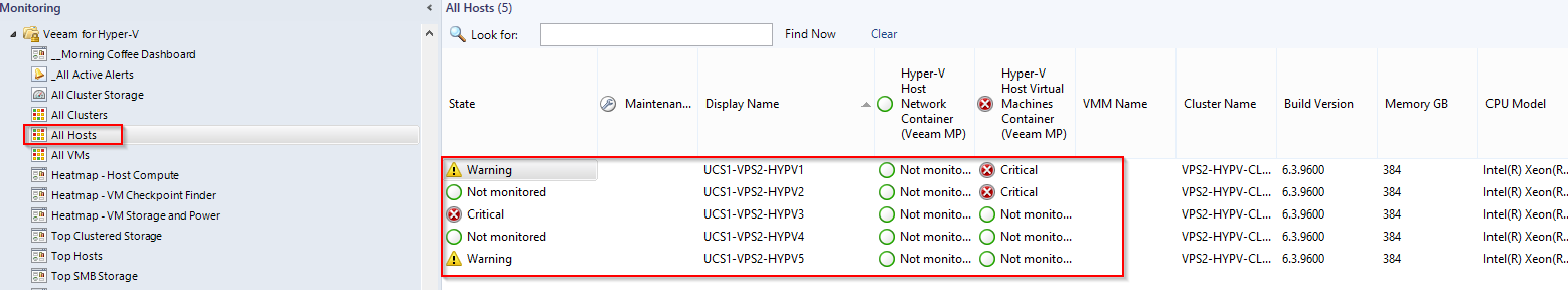

Having left this overnight, in the hope metrics are being collected, I logged on this morning to find they weren't .
Looking at the status of the hosts in SCOM, I see that the "Hyper-V Host Virtual Machines Container (Veeam MP)" is reporting 3 of the hosts as 'not monitored', could this be the reason that the VM metrics are not being collected?

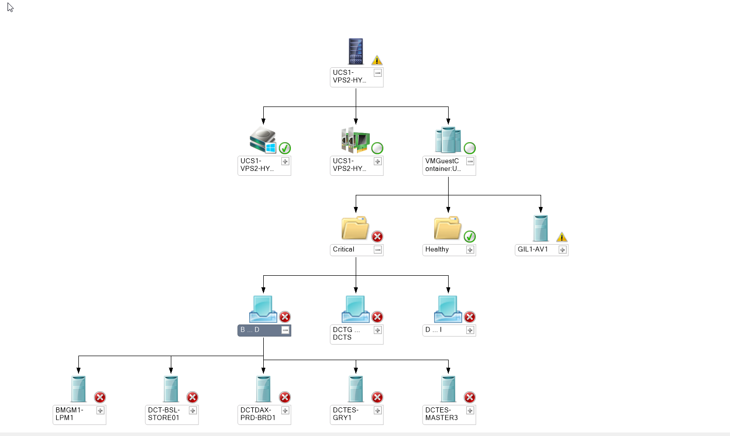

Well the HOSTs are monitored - this is the first column in the State view. But it's the Virtual Machine CONTAINER on those Hosts which is Not Monitored.
Could be because there are no VMs 'attached' to those Hosts - therefore no state to roll up. If you open a Diagram view (right click Host - Open - Diagram View) - are there VMs in the container?
Could be that our discovery has not updated the VMs and moved them to the new Host.
