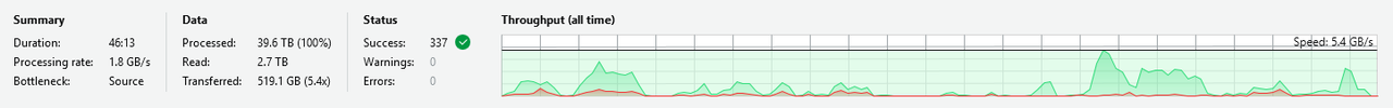

so I've run an active full backup on our workloads and then an incremental.
The incremental run through appeared to be about 10 minutes faster than the equivalent V12 setup which is great (see screen shot).
So only outstanding two issues for me are;

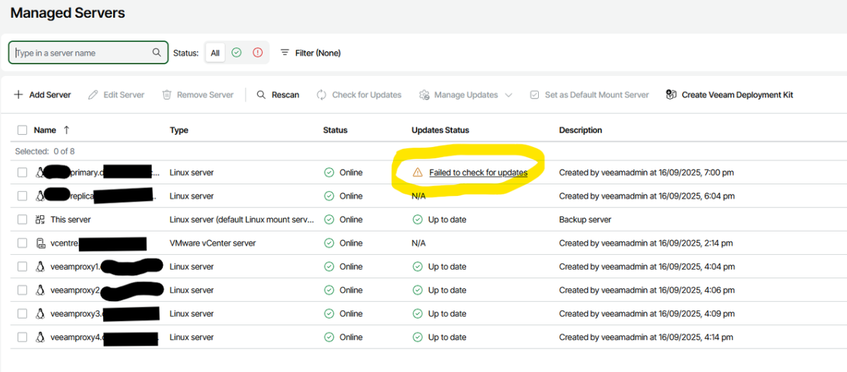

- I still can't figure out why our primary repository server (Rocky9 Linux, just like the replica server) shows as "Failed to check for updates". See image below despite the DNS and other settings being the same on both servers. I think it was because I tried to install the deployment kit onto the "broken" server originally, so suspect the machineid has persisted into the Veeam database somehow, but I haven't been able to trace it.
Please raise a support ticket and share the case ID with us. Since we dont manage the updates for Bring Your Own Linux installation likely it's caused by remote components update as you've suspected, but we would love to take a look at the logs.
