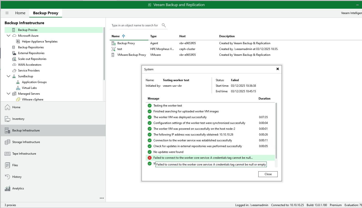

Hi everyone, I'm setting up a proof of concept (PoC) using the HPE VM Essentials plugin and I'm getting an error when trying to deploy the worker.
The VM deploys correctly to the VME cluster and responds to pings, but it ultimately fails.
Any ideas?
"Failed to connect to the worker core service: A credentials tag cannot be null or empty"

The issue happened when adding HPE Morpheus VME server to backup infrastructure.
When adding the server we create a service account on every cluster node which is managed by this server. That account is used for SSH connection to cluster nodes during backup in NBD mode.
In order to do it we call execution script request on HPE side.
In logs I see that the request was successful for the 1st and 2nd cluster node:
2025-12-02 18:49:44.3375 00021 [48867] INFO | [MorpheusController]: Successfully configured SSH access to the cluster host 1, IP address "10.10.10.81"
2025-12-02 18:49:45.0680 00019 [48867] INFO | [MorpheusController]: Successfully configured SSH access to the cluster host 2, IP address "10.10.10.82"
But it failed for the 3rd node:
2025-12-02 18:49:45.0680 00019 [48867] INFO | [MorpheusController]: Configuring SSH access to the cluster host 3, IP address: "10.10.10.83"
2025-12-02 18:49:51.3399 00019 [48867] ERROR | [MorpheusController]: Failed to configure additional settings for the HPE Morpheus VM Essentials clusters: Failed to execute the script: status Failed, exit code , error: , status message: : Veeam.Vbf.Common.Exceptions.ExceptionWithDetail: Failed to execute the script: status Failed, exit code , error: , status message:
As a result we haven't created service account on the 3rd node and haven't saved SSH credentials to VBR database.
I see later in logs that for master server (Morpheus):
2025-12-03 16:53:23.2501 00006 [441867] DEBUG | [DbProvider client]: ==> Response "Get" "https://localhost:6172/api/masterServers", "code: 200", duration: "13 msec", headers: "[]", cookies: "[]", body: "
"ServiceUserCredentialsTag\\\":null
which causes that error - A credential tag cannot be null or empty.
Could you please answer a few questions
1) Did you have any errors on Apply step when registering HPE VME server in VBR?
2) Has the server been registered in VBR if there were errors in session?
3) Is the 3rd node working - 10.10.10.83. Is it possible to ping it from VBR?
4) Have you tried to go through Edit HPE VME server wizard? Normally we have to check for missing SSH credentials and re-create them.
If editing doesn't help you can try to re-add HPE VME server to VBR and check logs for "Successfully configured SSH access" messages for all cluster nodes.
Meanwhile I will try to do reproduce similar behavior on my lab and share results. Looks like a bug on our side with managing such cases.

Hi EvgenyBaev, thanks for all your analysis.
I was able to verify that there was an error in Node.3, and the VBR13 appliance couldn't connect to it.
I also resolved some DNS issues. The inventory was created using the VME manager name without including the full domain or FQDN. For some reason, the worker couldn't resolve the default search zone and couldn't connect to the cluster. By changing the inventory name to the VME cluster's IP address, the worker passed all the tests and is now working.
I should add that I performed all these tests on both a Linux instance and a Windows instance, both running version 10.0.1.180.

Hi all,
we are a partner testing the VME Plug-In on Veeam B&R 13.0.1 (NFR license).
Once adding the VME host to Veeam B&R console, the feature for Deploy Worker is not working.
We have this error:
30/01/2026 11:17:43 Failed : Failed to deploy the worker VM: Failed to deploy the instance 23: Failed to create server (0:00:07)
These are some of the logs retrieved from Veeam B&R Console:
Code: Select all
2026-01-30 11:21:29.8828 00007 [13428] ERROR | [Worker][8660f4bd-84f6-455b-a577-43a86ff5ca1d][HD-VeeamWorker]: Failed to deploy the worker. ID 24, name: "HD-VeeamWorker": Veeam.Vbf.Common.Exceptions.ExceptionWithDetail: Failed to deploy the instance 24: Failed to create server
2026-01-30 11:21:29.8828 00007 [13428] ERROR | [Worker][8660f4bd-84f6-455b-a577-43a86ff5ca1d][HD-VeeamWorker]:    at Veeam.HpeMorpheusVmeBackup.RestClient.Client.HpeRestClientExtensions.EnsureInstanceHasStatusAsync(HpeRestClient restClient, Int64 instanceId, InstanceStatus status, CancellationToken cancellationToken)
2026-01-30 11:21:29.8828 00007 [13428] ERROR | [Worker][8660f4bd-84f6-455b-a577-43a86ff5ca1d][HD-VeeamWorker]:    at Veeam.PlatformService.BackupRestore.Workers.HpeSpecificWorkerManager.DeployWorkerInstanceAsync(BackupWorker worker, String imageId, VmAffinity affinity, String cloudInitConfigYaml, CancellationToken cancellationToken)
2026-01-30 11:21:29.8828 00007 [13428] DEBUG | [Morpheus][VME-MANAGER][49b560a2-dc9a-4fcc-a688-fbed2ad8c7e8]:  <== Request "Delete" "https://172.20.139.20/api/instances/24?force=on", headers: "[Authorization: ***]", cookies: "[XSRF-TOKEN: ***]", body: "{}"
2026-01-30 11:21:30.0352 00007 [13428] DEBUG | [Morpheus][VME-MANAGER][49b560a2-dc9a-4fcc-a688-fbed2ad8c7e8]:  ==> Response "Delete" "https://172.20.139.20/api/instances/24?force=on", "code: 200", duration: "147 msec", headers: "[Transfer-Encoding: chunked, Feature-Policy: vibrate 'none' ; microphone * ; camera 'none' ; gyroscope 'none' ; magnetometer 'none' ; geolocation 'none' ; midi 'self' ; notifications 'self' ; push 'self' ; sync-xhr 'self']", cookies: "[]", body: "{"success":true}"
2026-01-30 11:21:30.0382 00007 [13428] ERROR | [Worker][8660f4bd-84f6-455b-a577-43a86ff5ca1d][HD-VeeamWorker]: Failed to deploy the worker VM: Failed to deploy the instance 24: Failed to create server: Veeam.Vbf.Common.Exceptions.ExceptionWithDetail: Failed to deploy the instance 24: Failed to create server
2026-01-30 11:21:30.0382 00007 [13428] ERROR | [Worker][8660f4bd-84f6-455b-a577-43a86ff5ca1d][HD-VeeamWorker]:    at Veeam.HpeMorpheusVmeBackup.RestClient.Client.HpeRestClientExtensions.EnsureInstanceHasStatusAsync(HpeRestClient restClient, Int64 instanceId, InstanceStatus status, CancellationToken cancellationToken)
2026-01-30 11:21:30.0382 00007 [13428] ERROR | [Worker][8660f4bd-84f6-455b-a577-43a86ff5ca1d][HD-VeeamWorker]:    at Veeam.PlatformService.BackupRestore.Workers.HpeSpecificWorkerManager.DeployWorkerInstanceAsync(BackupWorker worker, String imageId, VmAffinity affinity, String cloudInitConfigYaml, CancellationToken cancellationToken)
2026-01-30 11:21:30.0382 00007 [13428] ERROR | [Worker][8660f4bd-84f6-455b-a577-43a86ff5ca1d][HD-VeeamWorker]:    at Veeam.Vbf.WorkerManagement.WorkerManagers.WorkerManager.<>c__DisplayClass136_0.<<DeployVirtualMachineAsync>b__2>d.MoveNext()
As you can see, we have tried 23 times.
We have already rebooted Veeam Server, rebooted VME host and VME manager multiple times, but the issue is still present.
I have already opened a ticket in Veeam (#07971174) but if you want to add here some advices to try to solve the issue, i will be very happy!
Thanks in advance
