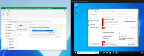

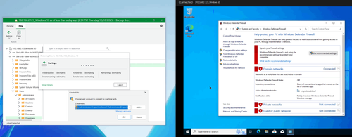

I did some tests with adding my windows machine to a domain.
FLR worked for me in both cases - when specifying login through "domain\username" and through "username@domain".
What about firewall settings on VBR side? You can try disabling firewall on VBR as well and check restore once again.

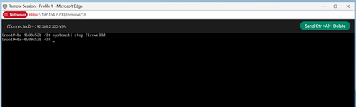

I tried to login through "domain\username" and through "username@domain", turn off firewall on VSA but still get the same error.
