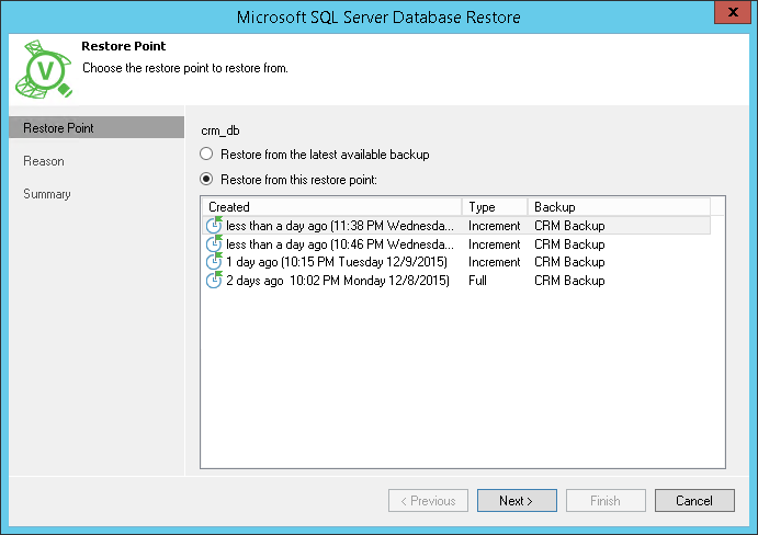

Hi,
If you mean that you observe no restore points with "Full" in the "Type" column specified in this wizard, then please contact our support directly so they can investigate as that does not seem right at all. Please don't forget to post your case ID.
Thanks!
Thanks!
