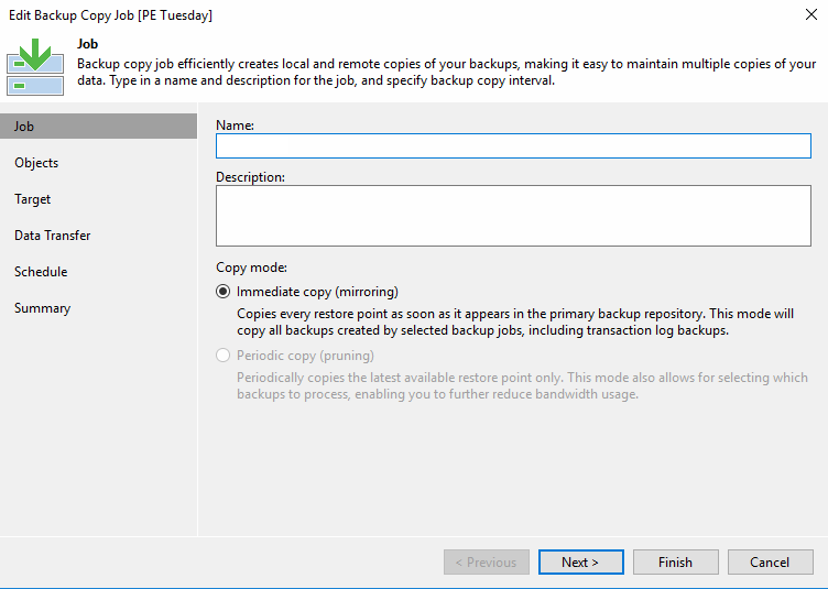

Copy mode is set to immediate copy (mirroring)
https://i.postimg.cc/HshHWcK4/screenshot-225.png

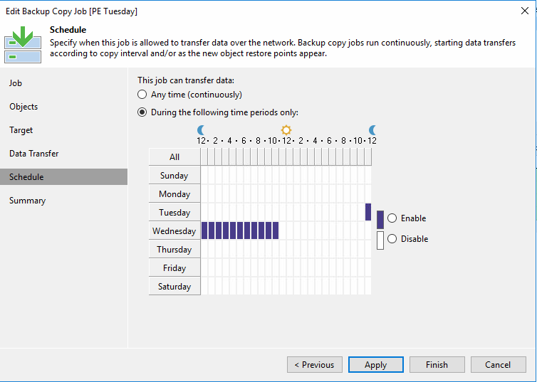

Schedule:
https://i.postimg.cc/76wrtgGD/screenshot-226.png
Schedule:

With Copy mode "immediate copy", veeam will copy every restore point from the source (Jobs, Repo) to the target backup repository. All restore points of the entire week needs to be copied in one night.
Your time Window is 11 hours on a Wednesday. If new backup files were created that night, Veeam needs to copy them too. So I assume, it will fail when your backup window is reached.

But your second screenshot shows us, the time window is only on Wednesday?it runs nightly. Backup copy window from 10PM to 9AM the following day, when it finishes early like 8 hours, it runs again the job after couple of minutes which is what I am trying to avoid.

ah yeah, that was for Wednesday backup copy job only. It's categorized daily and per VM. We also have Thursday, Friday and so on.
