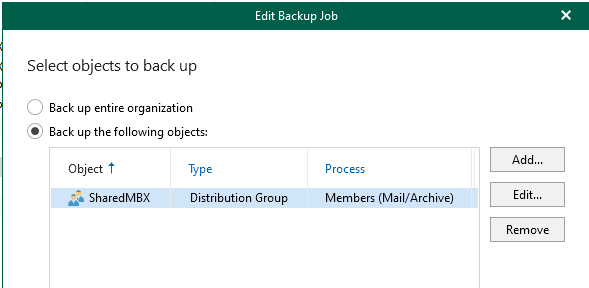

Have you already tried adding the shared mailboxed with the help of Groups?
You can create a Group on Exchange Online, add the shared mailboxes to that group.
When creating the backup job in VB365, add the group as a source and everytime the backup jobs runs, VB365 will backup all shared mailboxes in that group.
If you have already an automatic user/shared mailbox enrollment process, you can add the shared mailbox automatically to the group. This would be the simplest solution to achieve your goal.

For now, I went the route of adding the high priority shared mailboxes to a group, and creating a backup job based on the group. Once I did that, the mailbox backups began to update properly.
