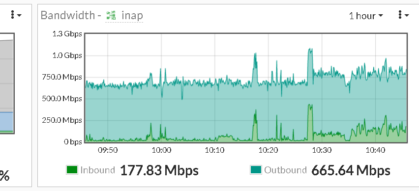

My issue appears resolved, it said my bottleneck was "Network". When I upgraded from Veeam 11 to 12 "Use Multiple Upload Streams" was set to 4. Veeam 12 has changed how it sends data and for some reason 4 is not enough anymore to get full speed. Im at "20" streams and I now see full pipe bandwidth. I tried unchecking this option in V12 which made it worse, where in V11 it made no difference, I see full speed. Try changing this and see if it makes a difference for you.

Waited a bit to make sure, but this is the final result. Super happy now :mrgreen:
Mildur
Product Manager
Posts: 12157
Liked: 3485 times
Joined: May 13, 2017 4:51 pm
Full Name: Fabian K.
Location: Switzerland
Contact:
Re: Anyone else having issues with Backup Copy jobs in V12? -- SLOOOWWWWW
Post by Mildur » 2 people like this post
Speed looks great again. :)
Thanks for coming back and sharing the solution from the case.
Best,
Fabian
Product Management Analyst @ Veeam Software
