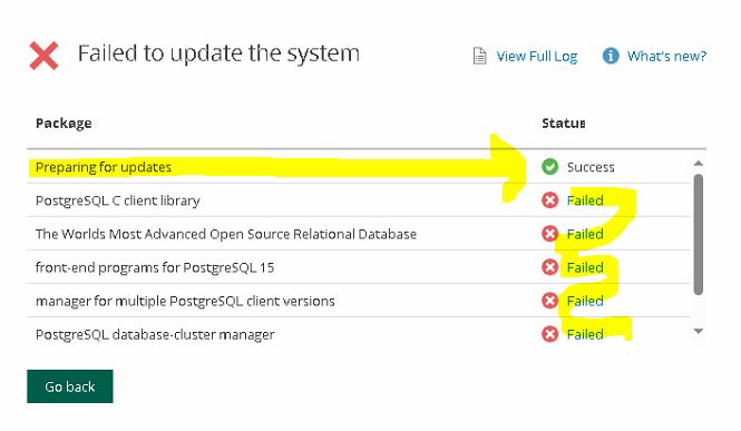

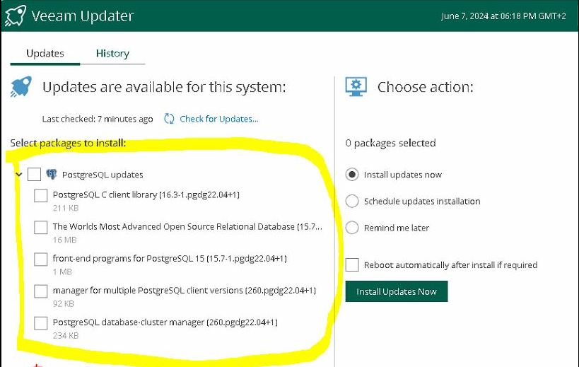

Hi everybody,
anyone with the same error here? Product Version 5.1.0.7 ...
We get this error on 8 different Veeam Nutanix Proxy Appliances :twisted:

I could successfully install other Proxy Appliance updates and rebooted all Proxies, but the PostgreSQL-updates fail on all 8 Proxy Appliances, even after reboot. SSH is already enabled and network changes have not been applied, as then the other updates would have failed as well.
Maybe it has to do with the older VBR server version 12.1.1.56 ? I will check that later and update to 12.1.2.172 first, before updating Proxies again. Never had any problems with updates on the Nutanix Proxy Appliances.

Ok, silly assumption that an upgrade to VBR 12.1.2.172 would solve the problem (seperate instance). According to the Nutanix Proxy Applilance logs, it looks like *.deb might be blocked from our internal proxy. Other updates went fine until now.

Ok, here is an update ...
Our proxy experts told me, that *.deb files do not get blocked!
This is the error we get ...
PostgreSQL C client library status FAILED
W: Target Packages (main/binary-amd64/Packages) is configured multiple times in /etc/apt/sources.list.d/apt_postgresql_org_pub_repos_apt.list:1 and /etc/apt/sources.list.d/pgdg.list:1
W: Target Packages (main/binary-all/Packages) is configured multiple times in /etc/apt/sources.list.d/apt_postgresql_org_pub_repos_apt.list:1 and /etc/apt/sources.list.d/pgdg.list:1
W: Target Translations (main/i18n/Translation-en) is configured multiple times in /etc/apt/sources.list.d/apt_postgresql_org_pub_repos_apt.list:1 and /etc/apt/sources.list.d/pgdg.list:1
W: Target Packages (main/binary-amd64/Packages) is configured multiple times in /etc/apt/sources.list.d/microsoft-prod.list:1 and /etc/apt/sources.list.d/microsoft.list:1
W: Target Packages (main/binary-all/Packages) is configured multiple times in /etc/apt/sources.list.d/microsoft-prod.list:1 and /etc/apt/sources.list.d/microsoft.list:1
W: Target Translations (main/i18n/Translation-en) is configured multiple times in /etc/apt/sources.list.d/microsoft-prod.list:1 and /etc/apt/sources.list.d/microsoft.list:1
E: Failed to fetch http://apt.postgresql.org/pub/repos/apt ... _amd64.deb 403 MediaTypeBlocked [IP: x.x.x.x 8080]
E: Unable to fetch some archives, maybe run apt-get update or try with --fix-missing?
The Worlds Most Advanced Open Source Relational Database status FAILED
front-end programs for PostgreSQL 15 status FAILED
manager for multiple PostgreSQL client versions status FAILED
E: Failed to fetch http://apt.postgresql.org/pub/repos/apt ... b1_all.deb 403 MediaTypeBlocked [IP: x.x.x.x 8080]
PostgreSQL database-cluster manager status FAILED
apt-get update works but reports some permission problems.
Any idea how to continue?
