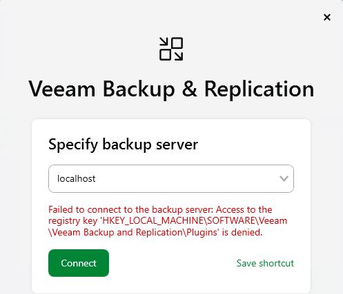

I recently updated a couple of VBR servers from 12.1.0.172 to 12.2.0.334. On one of the vbr servers it shows a popup with "some backup console's plug-ins must be updated to the latest version. This requires starting the application under an account with local administrator privileges. Would you like to do this now?"
Off course I clicked on yes and then the vbr console starts like it should and nothing else seem to happen. If I close the console and start again the popup gets shown again. I have looked in programs and features, and as far as I can see all items from veeam have the installation date from when I did the update.
how can I solve this?
I've also created a support ticket (#07417933) for this but I was curious if anyone else came across this and maybe have a solution.

Re: some backup console's plugins must be updated popup
Veeam Support suggested modifying this registry key, which has fixed the issue for me.
Open the Registry as an administrator and head over to the following location:
HKEY_LOCAL_MACHINE\SOFTWARE\Veeam\Veeam Backup and Replication
Find the "Plugins" Subkey and right-click on it.
Click on "Permissions"
In the window that opens, please ensure that the "Read" permission is enabled for "Authenticated Users".
If this permission is not present, please add it.
Once added, close the windows and close the Veeam Server UI and then reopen it.
The window warning about available updates should no longer appear.
Just updated to Veeam B&R 12.3.2.3617 and Authenticated Users Read access to the REG Key "Computer\HKEY_LOCAL_MACHINE\SOFTWARE\Veeam\Veeam Backup and Replication\Plugins" was removed again.
I got the UAC prompt to authenticate after saying Yes to update plugins, but it doesn't do anything to be honest. Close Veeam and open it again and its the same sh**show. Added the permission and now its fixed... until next update I guess.
I don't know why this is so hard for Veeam to address.

I too have just had the same issue with the upgrade to version 12.3.2.3617 on two different backup servers.

Thanks for this. The registry fix does get rid of the pop-up (after updating B&R to 12.3.2), but the "Veeam Plug-ins for Enterprise Applications" is stuck at 12.3.1. Isn't that the purpose of the original warning?

FYI, this happened on one of our VBR servers which was upgraded to v13, seems this bug is still lurking around. Adding Auth users with Read permissions in registry solved it.Mildur wrote: Jun 23, 2025 7:01 am Hi Alex,
