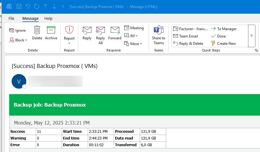

Just moved from vSphere to Proxmox in my lab and using Veeam to backup. Backup works fine, but I noticed a few things:
- the backup notification mail is missing the number of VMs backed-up in the subject. It reads ‘[Success] Backup Proxmox ( VMs)’

ok, thanks. About the number of VMs backupped, see:

I have this setting:
[%JobResult%] %JobName% (%VmCount% VMs) %Issues%
For vSphere backups this works fine. The number of VMs is being reported. Why does Proxmox use a different variable name then?
FrancWest
- Veteran
- Posts: 550
- Liked: 113 times
- Joined: Sep 17, 2017 3:20 am
- Full Name: Franc
- Contact:
Re: Things I noticed about Proxmox backup
Just tested it with %ObjectCount%. For a vSphere job, it returns the correct number of vms back-upped. However, for Proxmox the value is not the correct number of VMs. In my job it returns 2, but I back-upped 11 VMs. I also back-upped 1 vm and ObjectCount is still 2. The value 2 is the same as the number of Proxmox servers in the backup job. Is ObjectCount perhaps the number of objects (servers) in the job? This differs from a vSphere job, because I have 1 server in the job with 4 VMs and for the vSphere job ObjectCount returns the correct number of 4.

Hello Franc,
Yes, %ObjectCount% will include added objects. For example, if 1 VM and 1 Pool (containing 2 VMs) are added, it will show 2 objects.
Nevertheless, your request is noted.

Ok, but in a vSphere job this behavior is different. For that job I've added the ESXi server as the object to backup. According to your definition this should return '1 vm' in the notification mail, but it reports the actual number of VMs backupped. This differs from a Proxmox job.

So how do I get the actual number of VMs shown in the subject. Shouldn't %VmCount% also work for Proxmox jobs?

Hello Franc,
%VmCount% will also work for Proxmox jobs in upcoming releases.
