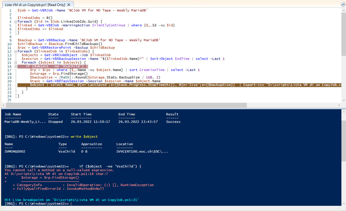

added
it's right or there's a better solution?
thanks again
at the end of the row "$object | select Name..."| Export-csv "D:\scripts\file_export.csv" -NoTypeInformation -Append
thanks again

Message is telling you exactly the issueGianlucaCroci wrote: Mar 30, 2022 5:48 am Good Morning Oleg,
now I've a result.
For some servers I've this message
related to "$storage = $rp.FindStorage()".
How can I save the result in a text usable? without the column header each time?
Thanks again
Write some logic to check if $rp is empty or not and skip processing of such points.
As for exporting it, CSV certainly works. You can also dump it to file with the Add-Content cmdlet from Powershell, but you need to play with it a bit.

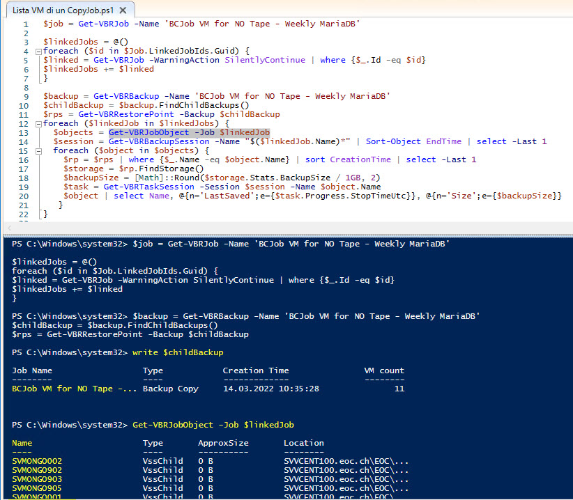

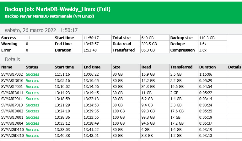

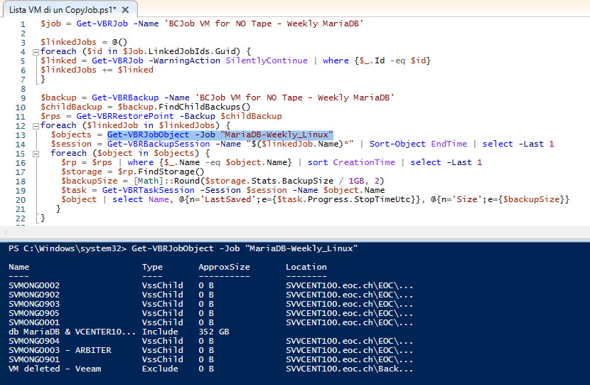

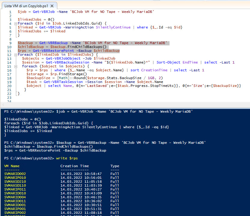

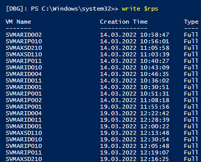

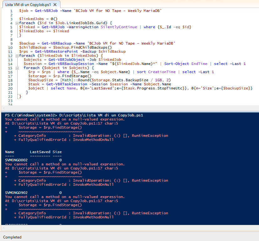

If i run the script on a Copyjob of different servers, it gives me a list but partial (not all server of this Copyjob are listed).
I then took another Copyjob, with fewer servers, to verify the execution.
In this Copyjob I should have "MariaDB" servers, but instead show me "Mongo" ones.
Up to the line
I tried to insert the Copyjob name in place of $linkedJob, as well as that of the "MariaDB Backup Job", but the result doesn't change.
I just don't understand what's wrong with it.
Up to the line
all good, but when I run this line I get precisely the "Mongo" servers.$objects = Get-VBRJobObject -Job $linkedJob

Can you maybe show what you run in the shell (screenshot and upload it to some image host), and maybe show the Backups under Backups > Disk (Copy)?
That the name didn't work makes me think it's about the processing of immediate copy jobs as they have a unique naming structure and have to be handled a bit differently.

GianlucaCroci
- Veteran
- Posts: 262
- Liked: 29 times
- Joined: Feb 26, 2019 12:08 pm
- Full Name: Gianluca Croci
- Contact:
Re: List VM of a CopyJob
execution FULL
execution partialy
execution partialy but with the row "Get-VBRJobObject -Job $linkedJob"
execution partialy but with the row "Get-VBRJobObject -Job "MariaDB-Weekly_Linux" "
last execution of the backup job "MariaDB-Weekly_Linux"
execution partialy

Hi Gianluca,
From what it looks like on the screenshots you shared, the problem might be with the job objects of VssChild type displayed upon Get-VBRJobObject execution. These are just for guest processing options and it most likely means that there is another level you adjusted them on. For instance, you backup a cluster, but also add vss options for a resource pool inside this cluster. Otherwise, the cluster would be recognized as of Include type only. So, if you exclude such job objects from processing, the script will stop searching for restore points for them. Inside the foreach ($object in $objects) loop try to wrap everything in the following if statement and see if it works:
Thanks,
Oleg
Code: Select all
if ($object -ne 'VssChild') {
$rp = $rps | where {$_.Name -eq $object.Name} | sort CreationTime | select -Last 1
$backupSize = [Math]::Round($storage.Stats.BackupSize / 1GB, 2)
$task = Get-VBRTaskSession -Session $session -Name $object.Name
$object | select Name, @{n='LastSaved';e={$task.Progress.StopTimeUtc}}, @{n='Size';e={$backupSize}}

Good morning Oleg,
same result.
used breakpoints, and here more info
RESULT
Thanks
same result.
RESULT
Thanks

Good morning Gianluca,
My bad, I must have forgotten to input $object.Type in the if statement. Should be like that:
Please try with the above and let me know how it goes.
Thanks,
Oleg
Code: Select all
if ($object.Type -ne 'VssChild') {
Thanks,
Oleg
Thanks a lot Oleg.
This is the last run. I've only the name of the Backup Jobs inserted into the CopyJob, and no Server name.
Thanks again
Thanks again
One another case I have in mind is it happens if there are no backups created for one of the source backup job.
Try to wrap storage query in not null validation like this:
Also, in the beginning of the script you could save time a bit invoking Get-VBRJob one time instead of two:
Thanks,
Oleg
Code: Select all
if ($rp -ne $null) {
Code: Select all
$jobs = Get-VBRJob -WarningAction SilentlyContinue
$copyjob = $jobs | where {$_.Name -eq 'Simple Backup Copy Job'}
$linkedJobs = @()
foreach ($id in $copyjob.LinkedJobIds.Guid) {
$linked = $jobs | where {$_.Id -eq $id}
$linkedJobs += $linked
Oleg

Hello Oleg,
I get the same result unfortunately.
I'll proceed in another way. I'll do an export from the Enterprise manager in Excel, with some manipulations to remove the "Tapes" and "CopyJobs".
I'd like to have a script, but since it gets too complex, I prefer to abandon this path and leave you time for other posts.
Thanks you for your effort and your time.

Hello Gianluca,
It's unfortunate that it keeps throwing the same error, but it only means that we didn't get the root cause of your specific case, where $rp variable is null.
Please let me know if you decide to get back to this script in the future.
Thanks,
Oleg
Thanks,
Oleg
