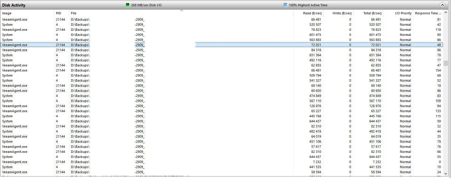

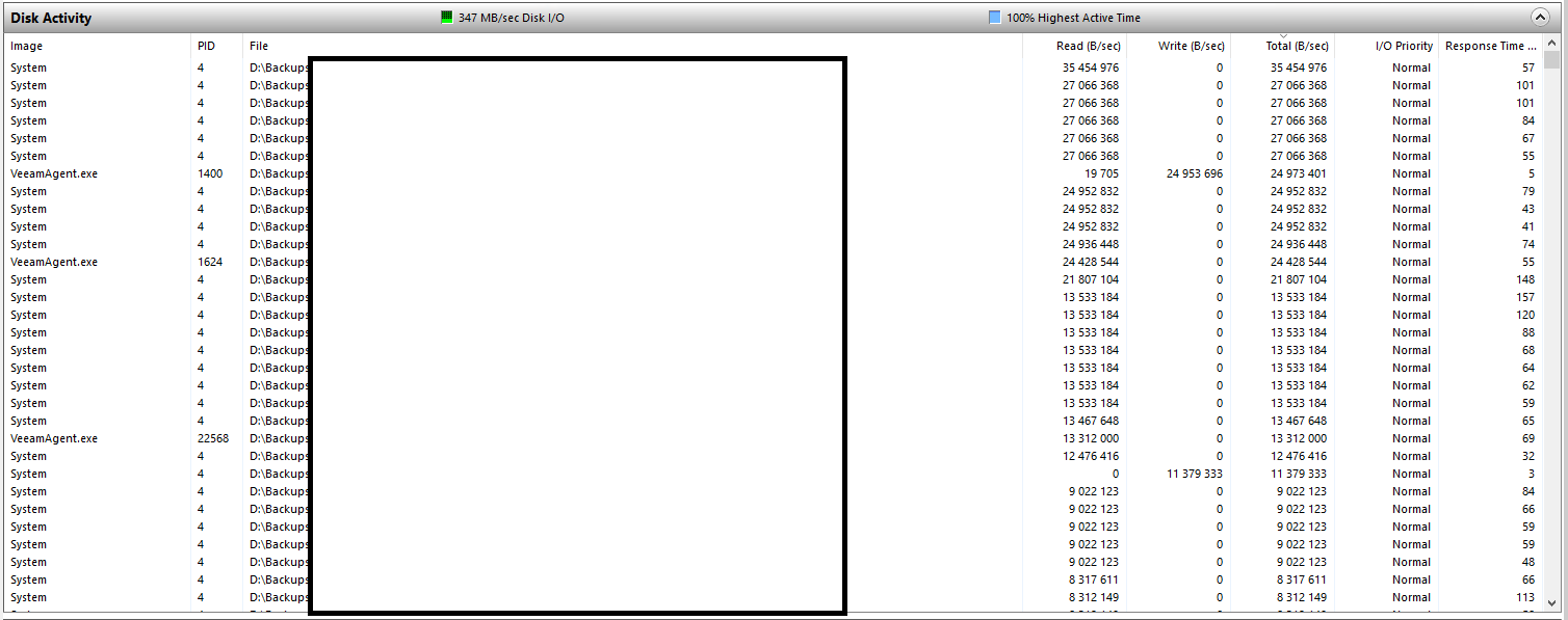

Re: Unusual read IO on backup repository during backup
I made a few screenshots for support ticket but I thought I'd share them here for illustration.
Top IO throughtput, all reads are various VIB files of different VMs (per-VM chains are used). A few writes are actual backup writes.
When sorting by file name, VIBs of the same VM are being read, billed to both VeeamAgent and System.

In conclusion:
- ReFS block clone is much more read intensive (reads from backup repository) than other filesystems/repository types. According to support it will try to clone blocks from all previous restore points (instead of rereading from SAN, as I understand) and that creates quite a lot of read IO, much more than for example NTFS.
- Defragmentation task is occasionally broken on Windows 2016/2019 (on various servers, scheduled task does nothing and defrag never runs). In my case after letting defrag run for about a week (and manually creating a separate scheduled task), job execution times dropped by 30-50% (70-80 minutes -> 40-50 minute range).
