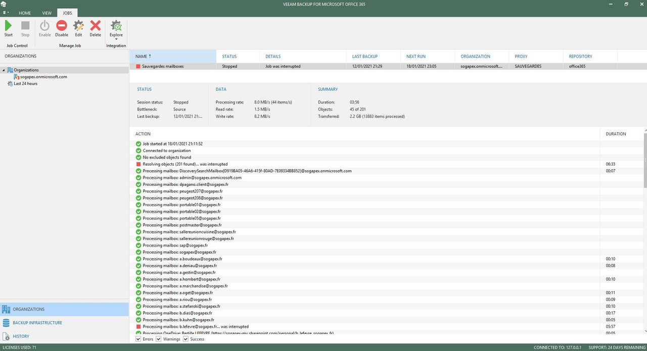

Hello,
we have been using VBO free for 10 of our mailbox successfully.
Now, we want to protect the whole company, and so, I get a demo licence (+10000) and add all the mailbox items to the backup job.
But it doesn't seem to work = everytime, we get a "job was interrupted" statement
Is it a known issue ? I don't get anything relevant about that

I see it is interrupted on a specific mailbox. Is it always the same?

I don't think so = many mailbox are "interrupted" each time before the job itself is interrupted

Here is the result of the support case =
There is not enough memory on our server. (16Gb for both Veeam B&R and VBO)
By setting the number of thread to 32 for the proxy server, il is ok
Method =
Open VBO365 UI and navigate to Backup Infrastructure. Select proxy, right-click and select Properties. 'Set the number of threads' to 32.

we got another "Job was interrupted" status.
And so, I decided to increase the backup server RAM amount (from 16Gb to 32Gb)
This server is already running Veeam B&R, and so, it seems it requires a lot of memory to get ride of both B&R jobs and VBO jobs when they are running at the same time I guess.
